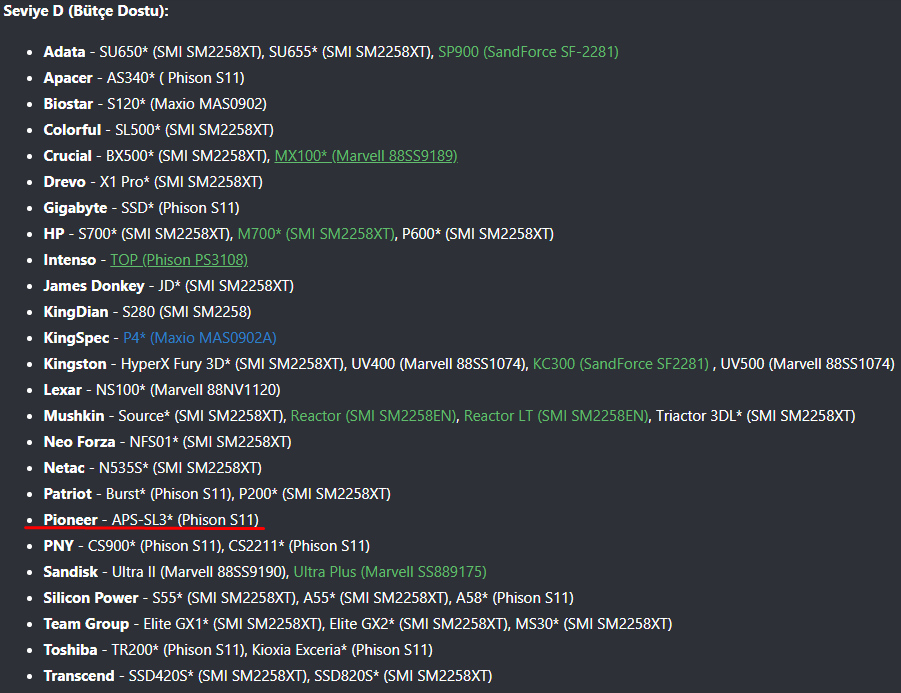

Seviye D (Ne İyi Ne Kötü Sınıf):
  • Adata - SX6000 Pro* (Realtek RTS5763DL), Gammix S5* (Realtek RTS5763DL), SX6000 Lite* (Realtek RTS5763DL), Swordfish* (Realtek RTS5763DL), S20G* (Realtek RTS5763DL)
  • Addlink - S68* (Phison E13T)
  • Asgard - AN1/AN2* (SMI SM2263XT)
  • Biostar - M700* (SMI SM2263XT)
  • Colorful - CN600* (SMI SM2263XT)
  • Corsair - MP500 (Phison E7)
  • Crucial - P1 (SMI SM2263), P2* (Phison E13T)
  • Gigabyte - NVMe v2* (Phison E13T)
  • Greenliant - ArmourDrive* (Phison E13T)
  • Goodram - PX500* (SMI SM2263XT)
  • Hikvision - E1000 (Phison E13T)
  • HP - EX900* (SMI SM2263XT), EX900 Pro (SMI SM2263)
  • Inland - Pro QLC* (Phison E13T)
  • Intel - 660p (SMI SM2263), 665p (SMI SM2263)
  • James Donkey - M.2 SSD* (SM2263XT)
  • Kingston - A2000 (SMI SM2263), NV1* (SMI SM2263XT)
  • KLEVV - KRAS C700 (SMI SM2263), KRAS C710* (SMI SM2263XT)
  • Lexar - NM600* (SMI SM2263XT), NM610* (SMI SM2263XT), NM620* (InnoGrit IG5216)
  • MLD - M300* (Phison ?)
  • MSI - M370* (Phison E13T)
  • Mushkin - Enhanced Helix-L* (SMI 2263XT)
  • MyDigitalSSD - BPX (Phison E7), SBXe* (Phison E13T)
  • Orico - V500* (SMI SM2263XT)
  • Patriot - P300* (SM2263XT ya da Phison E13T)
  • SanDisk - Ultra* (WD Proprietary)
  • Seagate - Barracuda Q5* (Phison E13T)
  • Silicon Power - P34A60* (SMI SM2263XT)
  • TC SUNBOW - NVMe* (SMI SM2263XT)
  • Team Group - MP33* (SMI SM2263XT ya da Phison E13T), Z330* (Phison E13T), T-Create Classic* (Phison E13T)
  • Toshiba - RC500 (Phison E12S), Exceria (Phison E12C)
  • Transcend - SSD 110S* (SMI SM2263XT)
  • Verbatim - Vi3000* (Phison E13T)
  • Western Digital - SN350* (WD Proprietary), SN500* (WD Proprietary), SN550* (WD Proprietary)

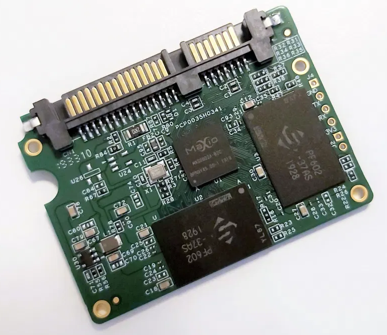

Maxio MAS0902 kontrolcüsü var, hızları vaat ettiğinin biraz altında.
550-525 diyor fakat yazma hızı genelde 450 civarında, okuma hızı doğru.
IOPS değerleri de ortalama denebilir, D-E seviye bir SSD denebilir.
Fakat tercih edilmemesini öneririm, aynı fiyata çok daha iyileri var.
Pek alınası bir SSD değil, OEM bir SSD resmen. :D

Pioneer SSD nasıl alınır mı?
Sistemlerin de var gamegarajın.Netac ile Pioneer arasında kaldım.
SSD bu, tamamdır.
Rehberde de var zaten.
Fiyatına göre iyi bir SSD fakat hızları düşük.
DWDP değeri de o kadar iyi değil.
Ben sana oradan SSD'yi çıkart derim.
10 TL daha koyup bunu alırsan daha iyi olur.
