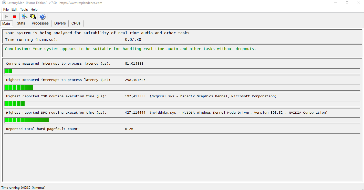

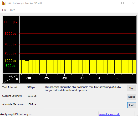

Arkadaşlar merhaba, stuttering sorunu yaşamaktayım ve aynı zamanda sistemde gecikme sorunu mevcut. Bugün format attım uzun zamandır atmıyordum, format atmadan önce bir şeyler yapmıştım ve DPC Checker programında gecikmeyi azaltmıştım ama Mouse'yi hareket ettirdiğimde çoğalmaya başlıyordu. Şu anda da ne yaparsam yapayım sabit. Analiz edebilecek bilgili arkadaşlar var mı acaba? Çok yardımınız lazım teşekkür ederim şimdiden.
Kod:
_________________________________________________________________________________________________________
CONCLUSION
Your system appears to be suitable for handling real-time audio and other tasks without dropouts.
LatencyMon has been analyzing your system for  0:07:46  (h:mm:ss) on all processors.
SYSTEM INFORMATION
Computer name:                                        DESKTOP-1VIGFLF
OS version:                                           Windows 10, 10.0, version 2009, build: 19042 (x64)
Hardware:                                             All Series, ASUS
CPU:                                                  GenuineIntel Intel(R) Core(TM) i7-4790 CPU @ 3.60GHz
Logical processors:                                   8
Processor groups:                                     1
RAM:                                                  4031 MB total
CPU SPEED
Reported CPU speed:                                   360 MHz
Note: reported execution times may be calculated based on a fixed reported CPU speed. Disable variable speed settings like Intel Speed Step and AMD Cool N Quiet in the BIOS setup for more accurate results.
MEASURED INTERRUPT TO USER PROCESS LATENCIES
The interrupt to process latency reflects the measured interval that a usermode process needed to respond to a hardware request from the moment the interrupt service routine started execution. This includes
the scheduling and execution of a DPC routine, the signaling of an event and the waking up of a usermode thread from an idle wait state in response to that event.
Highest measured interrupt to process latency (µs):   298,501625
Average measured interrupt to process latency (µs):   6,349420
Highest measured interrupt to DPC latency (µs):       294,939720
Average measured interrupt to DPC latency (µs):       2,846765
 REPORTED ISRs
Interrupt service routines are routines installed by the OS and device drivers that execute in response to a hardware interrupt signal.
Highest ISR routine execution time (µs):              192,413333
Driver with highest ISR routine execution time:       dxgkrnl.sys - DirectX Graphics Kernel, Microsoft Corporation
Highest reported total ISR routine time (%):          0,083629
Driver with highest ISR total time:                   dxgkrnl.sys - DirectX Graphics Kernel, Microsoft Corporation
Total time spent in ISRs (%)                          0,085592
ISR count (execution time <250 µs):                   172158
ISR count (execution time 250-500 µs):                0
ISR count (execution time 500-1000 µs):               0
ISR count (execution time 1000-2000 µs):              0
ISR count (execution time 2000-4000 µs):              0
ISR count (execution time >=4000 µs):                 0
REPORTED DPCs

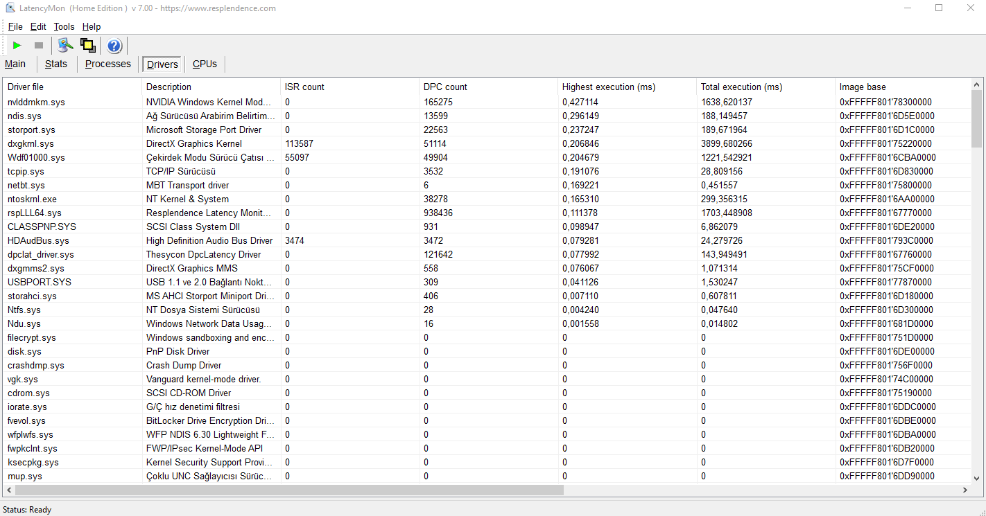

DPC routines are part of the interrupt servicing dispatch mechanism and disable the possibility for a process to utilize the CPU while it is interrupted until the DPC has finished execution.
Highest DPC routine execution time (µs):              427,114444
Driver with highest DPC routine execution time:       nvlddmkm.sys - NVIDIA Windows Kernel Mode Driver, Version 398.82 , NVIDIA Corporation
Highest reported total DPC routine time (%):          0,045678
Driver with highest DPC total execution time:         rspLLL64.sys - Resplendence Latency Monitoring and Auxiliary Kernel Library, Resplendence Software Projects Sp.
Total time spent in DPCs (%)                          0,165081
DPC count (execution time <250 µs):                   1410065
DPC count (execution time 250-500 µs):                0
DPC count (execution time 500-10000 µs):              5
DPC count (execution time 1000-2000 µs):              0
DPC count (execution time 2000-4000 µs):              0
DPC count (execution time >=4000 µs):                 0
 REPORTED HARD PAGEFAULTS
Hard pagefaults are events that get triggered by making use of virtual memory that is not resident in RAM but backed by a memory mapped file on disk. The process of resolving the hard pagefault requires
reading in the memory from disk while the process is interrupted and blocked from execution.
NOTE: some processes were hit by hard pagefaults. If these were programs producing audio, they are likely to interrupt the audio stream resulting in dropouts, clicks and pops. Check the Processes tab to see
which programs were hit.
Process with highest pagefault count:                 lightshot.exe
Total number of hard pagefaults                       6206
Hard pagefault count of hardest hit process:          1606
Number of processes hit:                              49
 PER CPU DATA
CPU 0 Interrupt cycle time (s):                       21,209445
CPU 0 ISR highest execution time (µs):                192,413333
CPU 0 ISR total execution time (s):                   3,156607
CPU 0 ISR count:                                      167583
CPU 0 DPC highest execution time (µs):                427,114444
CPU 0 DPC total execution time (s):                   5,358383
CPU 0 DPC count:                                      1229029
CPU 1 Interrupt cycle time (s):                       14,069390
CPU 1 ISR highest execution time (µs):                167,021111
CPU 1 ISR total execution time (s):                   0,035310
CPU 1 ISR count:                                      4571
CPU 1 DPC highest execution time (µs):                204,678889
CPU 1 DPC total execution time (s):                   0,179842
CPU 1 DPC count:                                      9177
CPU 2 Interrupt cycle time (s):                       9,868533
CPU 2 ISR highest execution time (µs):                2,204444
CPU 2 ISR total execution time (s):                   0,000006
CPU 2 ISR count:                                      4
CPU 2 DPC highest execution time (µs):                151,677778
CPU 2 DPC total execution time (s):                   0,106880
CPU 2 DPC count:                                      11719
CPU 3 Interrupt cycle time (s):                       13,947018
CPU 3 ISR highest execution time (µs):                0,0
CPU 3 ISR total execution time (s):                   0,0
CPU 3 ISR count:                                      0
CPU 3 DPC highest execution time (µs):                104,928889
CPU 3 DPC total execution time (s):                   0,013110
CPU 3 DPC count:                                      1635
CPU 4 Interrupt cycle time (s):                       12,353499
CPU 4 ISR highest execution time (µs):                0,0
CPU 4 ISR total execution time (s):                   0,0
CPU 4 ISR count:                                      0
CPU 4 DPC highest execution time (µs):                113,407778
CPU 4 DPC total execution time (s):                   0,101176
CPU 4 DPC count:                                      12070
CPU 5 Interrupt cycle time (s):                       14,662466
CPU 5 ISR highest execution time (µs):                0,0
CPU 5 ISR total execution time (s):                   0,0
CPU 5 ISR count:                                      0
CPU 5 DPC highest execution time (µs):                115,575556
CPU 5 DPC total execution time (s):                   0,027474
CPU 5 DPC count:                                      3286
CPU 6 Interrupt cycle time (s):                       12,632232
CPU 6 ISR highest execution time (µs):                0,0
CPU 6 ISR total execution time (s):                   0,0
CPU 6 ISR count:                                      0
CPU 6 DPC highest execution time (µs):                296,148889
CPU 6 DPC total execution time (s):                   0,082573
CPU 6 DPC count:                                      7292
CPU 7 Interrupt cycle time (s):                       16,482186
CPU 7 ISR highest execution time (µs):                0,0
CPU 7 ISR total execution time (s):                   0,0
CPU 7 ISR count:                                      0
CPU 7 DPC highest execution time (µs):                191,075556
CPU 7 DPC total execution time (s):                   0,286824
CPU 7 DPC count:                                      135862
