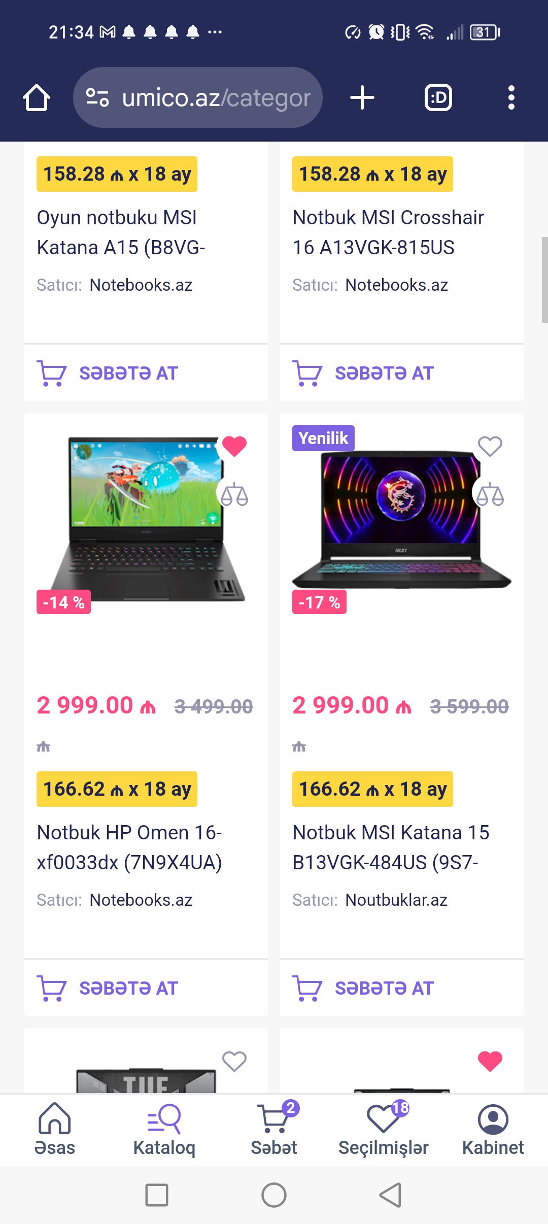

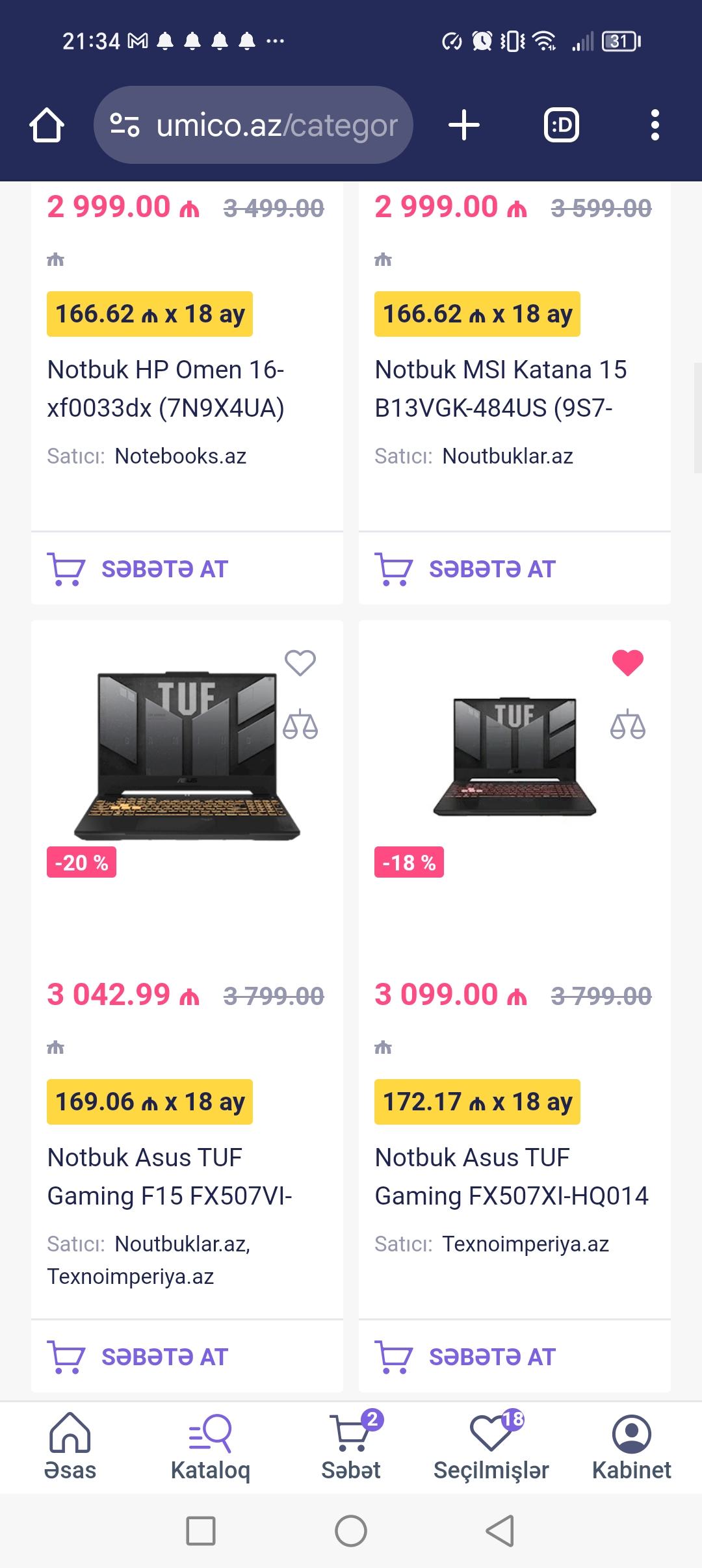

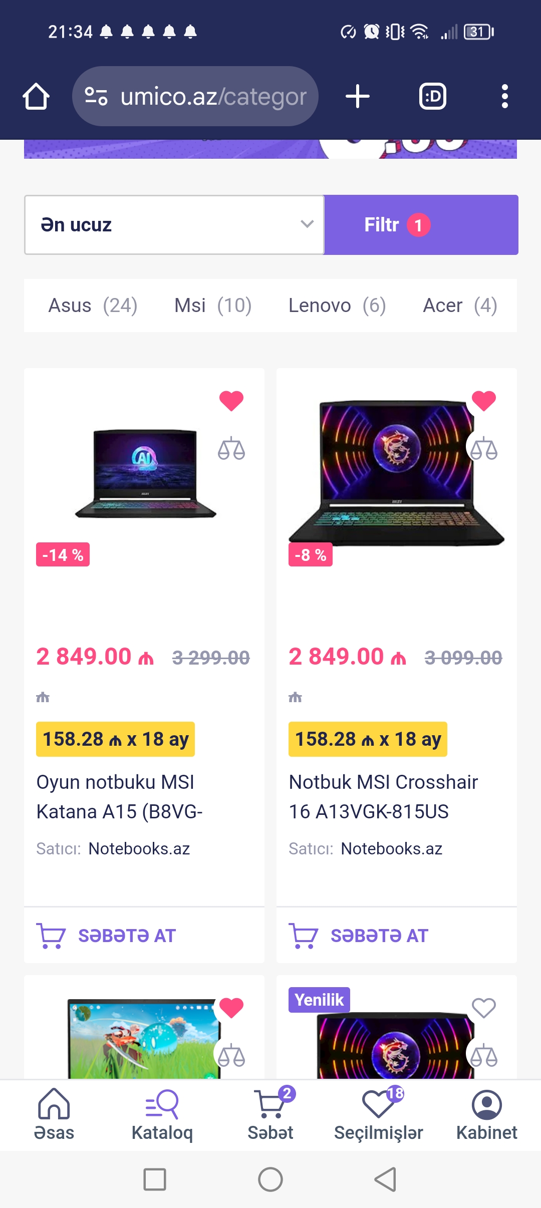

Msi crosshair 16 var ala biləcəyim ama İşlemci kotu İ7 13620H bide asus tuf gaming FX507XI-HQ014 var rtx 4070 ryzen 9 7940hs
    577.5 KB · Hit: 54
    546.6 KB · Hit: 60
